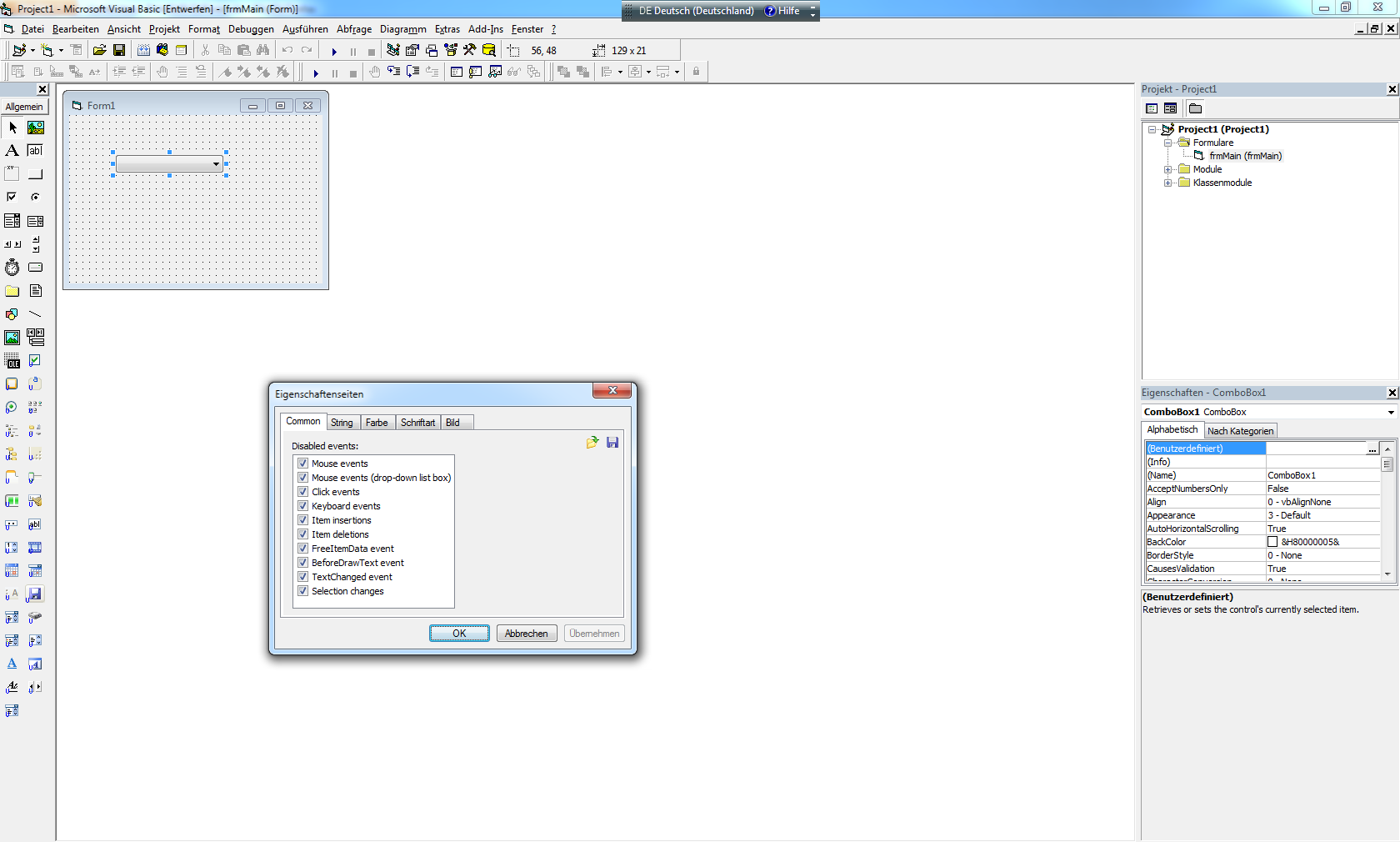

I don't have a tool called the "form designer." In the standard VB6 IDE I can see properties for the ComboBox but I don't find anything related to "click events." aTiKu, are you using some other tool to get at more features of the ActiveX controls at design time than what comes native to VB6?

Re: Combobox
See this screenshot:pgrimmer wrote:I don't have a tool called the "form designer." In the standard VB6 IDE I can see properties for the ComboBox but I don't find anything related to "click events."

Re: Combobox
Thanks. I thought I had tried right-click then Properties and it had taken me to the standard VB6 Properties box but now I see that it doesn't. That's helpful.
