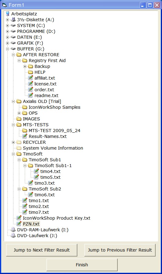

Re: Filter Results
Posted: 06 Sep 2009, 16:29
by aka
Hi TiKu,
sorry for my late reply. I did not had the time to test your last post earlier. It is a really big step forward and I owe you at least a TerraByte of thank. Unluckily, the code still is working correct only with limitations. These limitations are related to the up or down changing of the level at which the last filter result was found. An example: Selecting directly the "TimoSoft" folder I send you, everythings works as expected. On my PC this folder is located on drive "G:\", where several other folders a stored above, some of them containing filter results too (please see attached screenshot). What happens is:
1. Selecting "G:\" and clicking on "Jump to Next Filter Result" without expanding any root folders before, makes "...affiliat.txt" visible and selected. Everything is fine until "...readme.txt" is reached. If this file is selected and you try to jump to the next filter result, the code stops searching and "...readme.txt" remains the selected item.
2. Expanding the folder "Axialis ..." by clicking it in the tree and then clicking "Jump to Next Filter Result" does not cause anything. From the display of the CPU load I can see the code working for a few seconds and then stopping without finding a result. BUT selecting its subfolder "IconWorkShop Sample" and clicking on "Jump to Next Filter Result" opens "MTS-TESTS->MTS-TEST 2009_05_24" and makes "Result-Names.txt" the selected item. This is correct, because this file is the next filter result after "...readme.txt".
3. A further click again does NOT jump to and open "TimoSoft", but remains at "Result-Names.txt".
4. Selecting folder "TimoSoft" and clicking several times, not only makes all filter results in this folder visible, but jumps to the following filter results in the root of "G:\".
Of course I tried out to figure out the reason for this strange behaviour (also with other drives/folders, the result is the same), but without success. Does it make any sense to you?
IMPORTANT: On your website I read, that this project is a hobby of you and I definetely don't want to be impudent or stress your nerves. So, if you are sick and tired of this topic, do me the favour to give me a short note: Hi aka, it is enough! Last but not least, because it seems to be very likely, that my idea to change the code for "Find Next" working the other direction, will cause unsolvable problems for me too. The whole matter is very much more difficult than I expected.
Best regards
aka
Demo_for_TimoSoft.zip
(8.06 KiB) Downloaded 2752 times
(94.13 KiB) Not downloaded yet

    If hNext = -1 Then
      ' try parent item's next sibling sub-tree
      hNext = hSelection
      Do
        hNext = .ItemGetParentItem(hNext)
        If hNext = 0 Then hNext = -1     ' special handling for ShowRoot = False
        If hNext = -1 Then
          ' we've reached the end of the tree
          Exit Do
        Else
          l = hNext
          hNext = .ItemGetNextItem(hNext)
        End If
        If hNext = -1 Then
          ' this parent does not have a sibling item
          hNext = l
        Else
          If ItemMatchesFilters(hNext) Then
            ' we've found a match
            Exit Do
          Else
            l = FindNextMatchInSubTree(hNext)
            If l <> -1 Then
              hNext = l
              Exit Do
            End If
          End If
        End If
      Loop
    End If
    If hNext <> -1 Then
      ' we've found a result
      .SelectedItem = hNext
      .ItemEnsureVisible hNext
    End If
  End With
End Sub

Hi TiKu:
I have a big problem: I don't know how to express my thanks in an appropriate way!
Thank you very, very much for your last post. Now the code is perfect and finds all filter results, no matter how deep thy are located in the tree and how "fare away" they are from the last result. It's fantatstic. Using this code I can try to make it working in the other direction for "Jump to Previous Filter Result".
Once again: a warm and honest thank for the fantastic control your great support!
