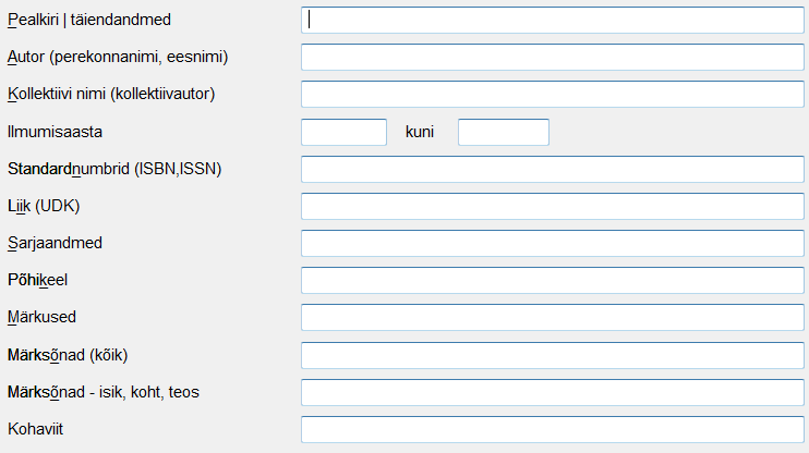

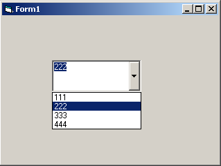

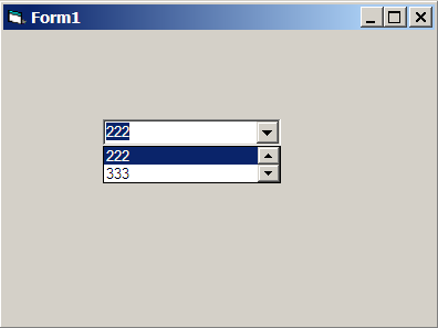

Re: ComoBox and DPI 120
I played around with some properties. ListHeight and MinVisibleItem does not solve anything.
But: Changing the SelectionFieldHeight property let the control behave strange:
Behaviour 96 DPI: The SelectionField height is set to the property value, the Dropdown height depends on the item count => expected!
Behavior 120 DPI: The SelectionField height is set to default height, the Dropdown height is set to the property value => not expected!
See attached screenshots with SelectionFieldHeight=40.
Unfortunately this is not a solution or workaround because changing this property would only help for exactly one DPI value.
I tried all for WinXP SP2/Sp3 and Win7. There is no difference.
I also attached a very simple VB6-Project without any additional references (zip-file).
I hope this is helpful.
- (5.31 KiB) Not downloaded yet
- (3.93 KiB) Not downloaded yet
- TestCBLCtlsU_1.1.1.zip
- (5.15 KiB) Downloaded 9860 times

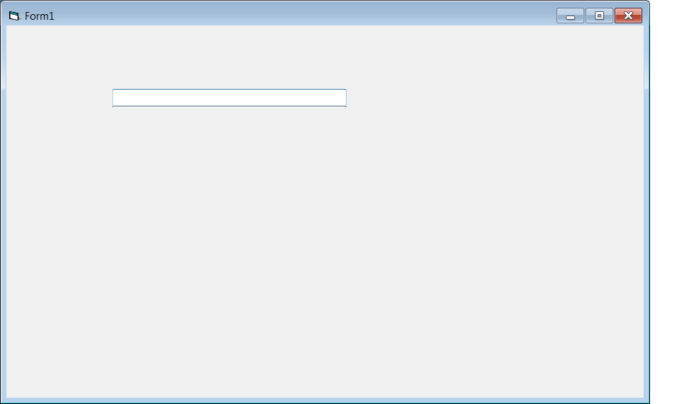

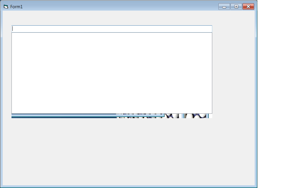

I am sorry but I had not much time to test the new version 1.1.2 in the last weeks.
Today I spended some more time with it.
I am also sorry to tell you that there are still problems with the combobox control:
If I set "Width" or "Height" property, the dropdown still is not shown with setting 120 dpi.
It is strange, because not all values of the properties effects the issue...
e.g. following values are affected:
ComboBox1.Width = 1500
ComboBox1.Height = 240
Do you have any idea?
