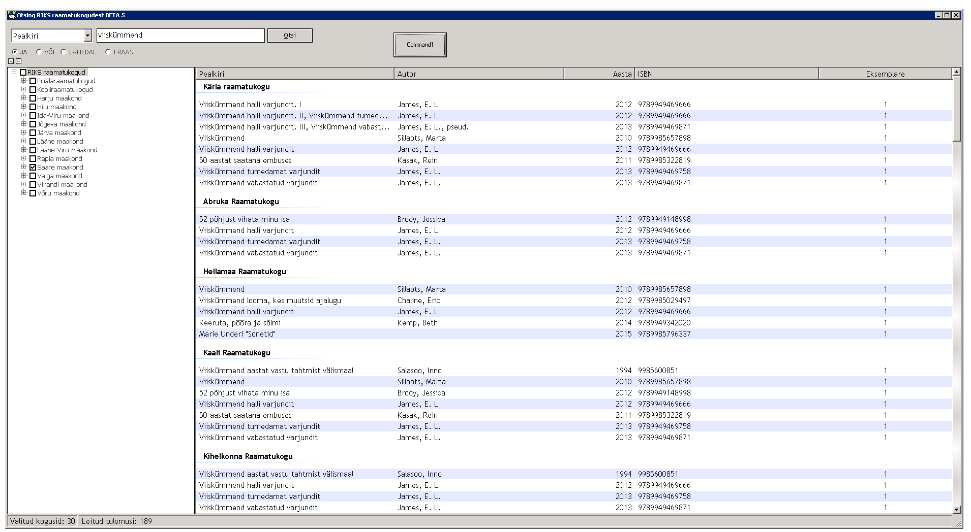

Hi Timo!
Is there a way to sort items, when groups are shown?
Sorting works fine, when groups are not show.
Sort items when groups are shown
- (50.2 KiB) Not downloaded yet
