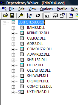

I've attached a screenshot of Dependency Walker that shows the files that EditCtlsU.ocx depends on. As you can see, it depends on nothing more but system core dlls. No VB6 files (the controls are written in C++) and no MFC stuff. It's the same for all my controls, except ExplorerTreeView 1.x and FlatButton (these are written in VB6).
