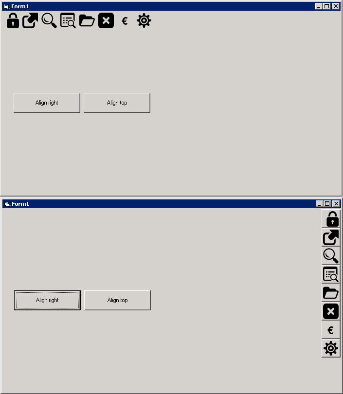

But how to change rebar/toolbar alignment at runtime? Setting Align at runtime is not working as expected. Align is only working when I use toolbar without rebar.
And couple "bugs" or something..
1) When I set ButtonStyle to flat and toolbar is aligned Top, everything looks ok. Now when I set align to Right, button visual look is changed to 3D, but property is still "flat".
2) Change rebar align to top at design time and try to change "Apperance". ReBar starts to flicker and VB6 IDE hangs.

Re: PNG as button image
Changing the rebar's orientation at runtime will recreate the control window. Recreation includes destroying the window. Destroying a window also destroys its child windows - the tool bar.
So it might work to detach the tool bar from the rebar while changing the rebar's orientation. This can be done by setting the band's hContainedWindow property to 0 (and afterwards to the tool bar's window handle to re-attach).
Regarding the 2 bugs: I've fixed no. 2. No. 1 seems to be caused by the internal behavior of the native tool bar control and I have not yet found a work-around.
OK, got it working now.
I found, that correct order is very important, how to change alignment. For example, if you change ReBar's properties first and then ToolBar properties, Buttons.Add method will fail.
And if you change ReBar's "Orientation" first and then "Align", ReBar starts flicker and applications hangs.
Method that's working now as excpected.
